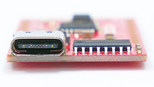

USB connector is now USB-C in R7:

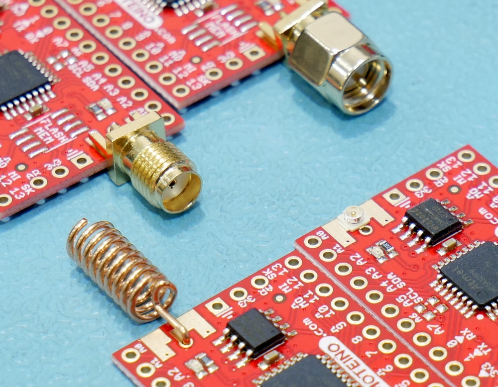

There are many options to connect antennas:
