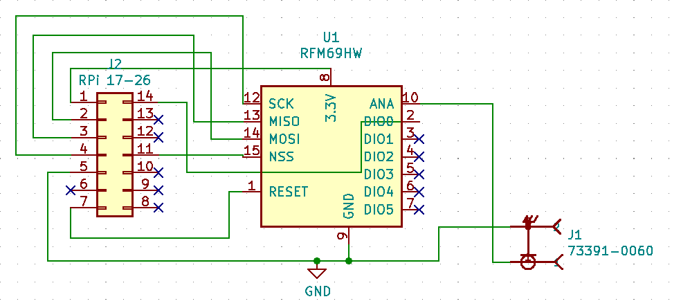

Hi there,
I couldn't find a simple Raspberry Pi Hat for the RFM69HW with just an SMA connector.

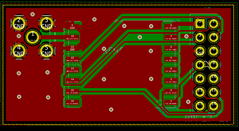

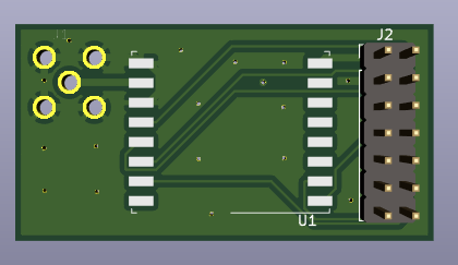

I've come up with the following if anyone had any feedback, particularly around the transmission line which I've surrounded with GND and kept as short as possible.
Ignore the pin header render - the header will be female and go underneath the board to connect to the rpi pins 17-26. I'll add silkscreen info as well.
Jason

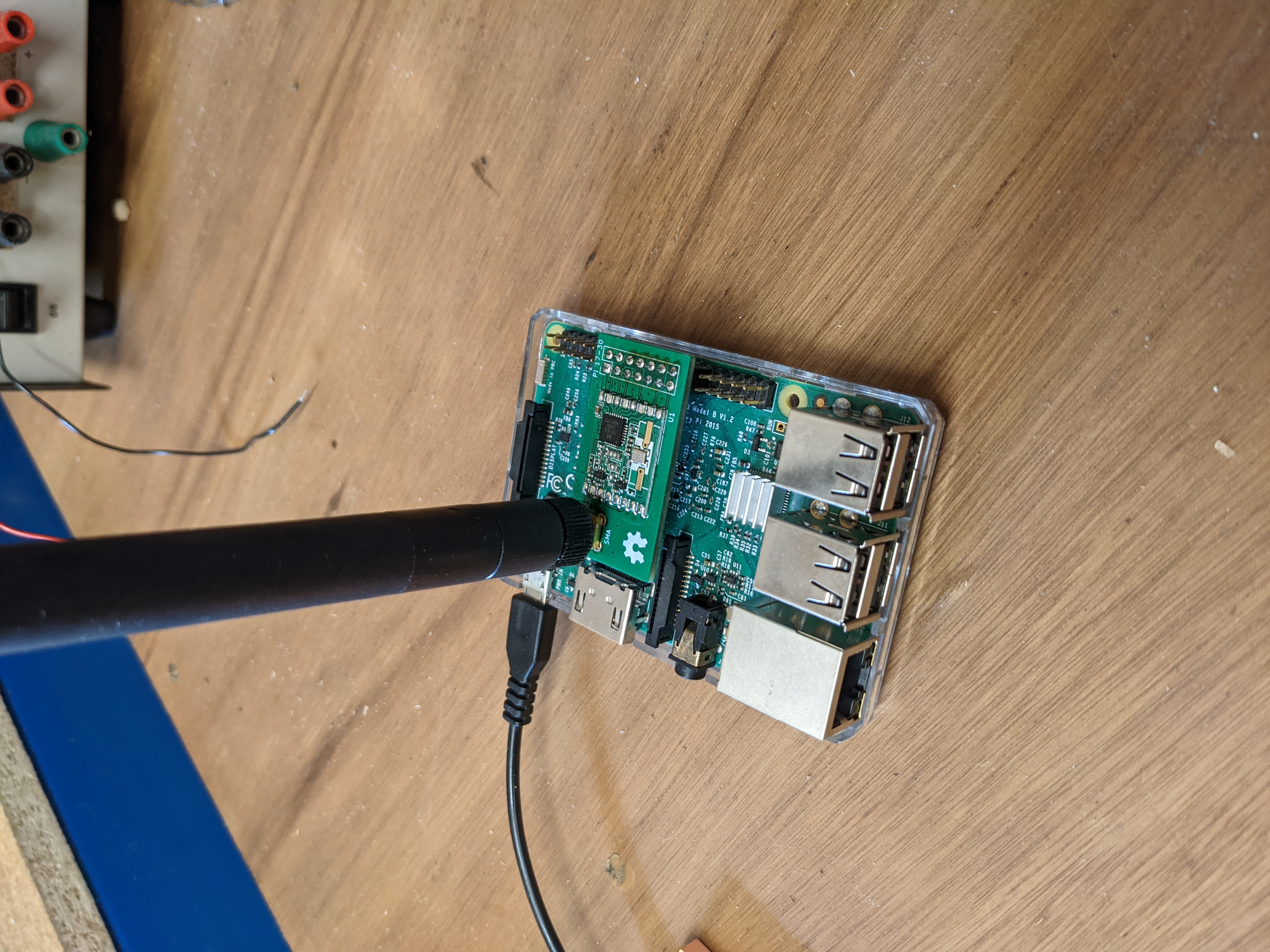

I did indeed make it and found two errors:
1. I messed up the footprint of the GPIO header; KiCad's default is left to right but on the Pi it's top to bottom
2. I guessed a trace width, instead of calculating an impedance matched trace.
I've since fixed 1 and 2 (with a coplanar waveguide with ground calculated using KiCad's tool) and am just waiting for the PCBs to (very very slowly) arrive from JLCPCB.
When it's up and running I'll share here.
The motivation for this is that I don't need the full functionality of the Pi Gateway/PiHat etc - I just need access to read/write packets from the RFM chip using the python wrapper https://pypi.org/project/rpi-rfm69/ so I can send on the data via MQTT to Home Assistant.
