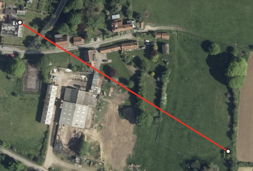

« Reply #3 on: April 06, 2022, 04:27:33 AM »
So I finally got around to climbing on my roof and attaching this dipole antenna via this 10m SMA cable extension into this PiHat for an RFM69.
Very pleased that I'm getting ~-70dBm over 25m 250m line of sight:

Re: Any tips for mounting an antenna on a house roof?
« Reply #4 on: April 06, 2022, 07:47:35 AM »
That's far more than 25m, did you mean 250m?  :o
And what you have there is not quite LOS, there are some obstacles.
Anyway, for the RFM69, with the dipole this is not even in the impressive range, but rather normal expected performance.
To put things into perspective, a HAB with dipole, to ground, at tweaked low bitrate, can achieve up to 200km range ;).
I want to see any of this done with ESP32  :'(

« Reply #5 on: April 06, 2022, 08:17:58 AM »
Ah yes 250m! And normal expected performance is absolutely a-ok with me, as a radio newbie I am very happy it is working at all...
