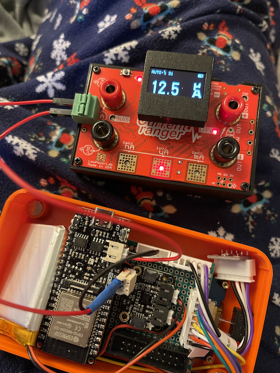

Hi,
I'm trying to update my current ranger, I bought it a couple of weeks back from electron and double-pressing the power button doesn't appear to do much, it doesn't seem to go into any kind of bootloader, the OLED display indicates it's just running as normal.
Does my unit have old firmware without this ability? (I thought it would be up to date given how I only bought the unit now). Upon boot, it's showing firmware 1.0.0
Edit: I took it out of the box and the PCB says CurrentRanger R3 mk5, so as far as I can tell, this should support the firmware update described in your information.
I'm trying to update because I fitted the buzzer, and the thing beeping on me on auto range changes is driving me crazy, I'd say that the current behaviour is not what people would generally want, the light and/or display changes are sufficient.
The values displayed on the OLED are the values I need to keep?

Ok, I figured it out, I think the section on the website needs a bit more information.
1.) It's not the button on the front that you use to turn the device on/off that you need to press, it's a button on the back, this is obviously my fault, I just assumed it as the button on the front, I don't even remember seeing the button on the back and I soldered the UART header in a couple of hours ago and still didn't see it.
2.) The actual conversion of the firmware to a uf2 file and a note saying that you need to drag the file into the device, you can name it <anything>.uf2.
3.) Adding the uf2 python tool to your repo (license permitting, or as a submodule) and providing a script that converts the firmware to the necessary format.
I'm now up and running with the new firmware and no more beeps on the auto range change! Yay!

Yeah, I just missed it, I didn't spot the switch on the back when I was soldering in the header.
Even though the instructions say reset, my brain just kept linking the power button with reset, so I sat there for 30 minutes trying to figure out why I couldn't get into flash mode, this was probably in part because I had fixed the board into the case.
With the reset button being on the opposite side of the board it's easy to make the incorrect association, I just expected reset to be accessible on an assembled unit.
I may be the only person whose brain ever does this, but I figured it was worth mentioning.

I forgot to mention you can enter the bottloader by sending a 'r'+ENTER in the serial console (recent firmware). Then you don't need to access the RST button. I added this detail as well now.
Not sure about bigger OLEDs. I looked at a lot of options including TFTs etc. The bigger it is the more data processing and transmission is required. This OLED is well supported by libraries, easy to use, not too expensive, very portable, and can display quite a bit of info in the 128x64 area, various smaller fonts are available, I just used whatever was more common sense. The more you change on the display the more time it spends on drawing that to the display memory which takes from USB logging speed. But if you're attaching the OLED then it's assumed you're using that and not USB logging. If you start the unit without the OLED and it doesn't detect it, then it won't spend any time writing to it so USB logging speed will be faster.
