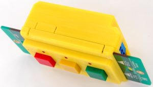

SwitchMote latest features & R&D
I’ve long wanted to make a professional enclosure for SwitchMote and do away with the acrylic covers and all the screws and spacers. All these parts add a lot of overhead and cost to the kit.
SwitchMote was designed to be a DIY modular/hackable/educational kit (so far at least) that uses mostly “off the shelf” parts. In the past months I’ve invested into a SwitchMote enclosure design. The PSU side would be cool in clear plastic, below is a rendering:
The good news is this can be made very solid and simply snaps onto the top and bottom PCBs with some cleverly designed tabs, without the need to use any spacers or screws or other exotic mating methods. I like to simplify and KISS everything. The enclosure can also accomodate the recently released PIR option, below is a prototype:
The bad news is the eye watering cost to make the moldings for this. The cost of UL certified fire retardant material is also expensive. I would need to put SwitchMote in HomeDepot or go to Shark Tank for that to make financial sense. So at this point I’m looking at alternatives, one option is silicone molds that can produce a few hundred units at most.
Another option is to go the 3D printing route and make these right here in the shop. I’ve had a prototype built on an FDM printer and I’m quite happy with the quality and strength, the downside is detail. Because the front panel is the only exposed part, that could be covered in something else that is nice and smooth, and perhaps allow for any color the user wants.
There are many other ideas cooking as to make SwitchMote more feature rich, realiable and easy to use. For now an enclosure would be one step closer to professional looking (yet Arduino based) IoT switch (that doesn’t suck).
Ideas, suggestions, feedback and help are always welcome!

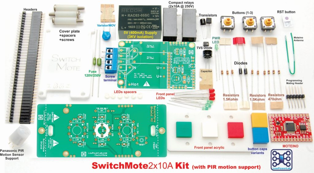

SwitchMote PIR motion sensor option
Quite excited to announce the new PIR sensor option on SwitchMote, this was requested by a user and is finally available in the shop. The chosen PIR sensor was the ultra low power Panasonic EKMB1201111 (same as offered in the MotionMote Kit). It’s a fantastic sensor, very small fully contained package, the only down side is these sensors are expensive. For this reason the kit is now significantly discounted for a limited time! You may source your own PIR of course (and mention you want the PIR parts at checkout), a forum user reported the older revision of these sensors might be found for cheap on eBay.
The SwitchMote Guide was updated with instructions for this change. Mainly the kit will come with 2 buttons and the PIR instead of 3 buttons, along with a required 10K pullup and the front cover matching the PIR sensor. Here is the updated kit content, notice the front PCB is different:
