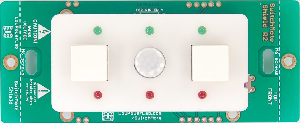

For programming and testing purposes, you can power and upload sketches via an FTDI-Adapter, just plug your FTDI-Adapter via the provided double header into the SwitchMote as seen below:
Never connect to SwitchMote via FTDI adapter/programmer while wired to mains!

If your SwitchMote has the PIR sensor option you will need to get this sketch instead. The middle button and the PIR output are shared to D5. This sketch monitors D5 for motion rather than a button press.
