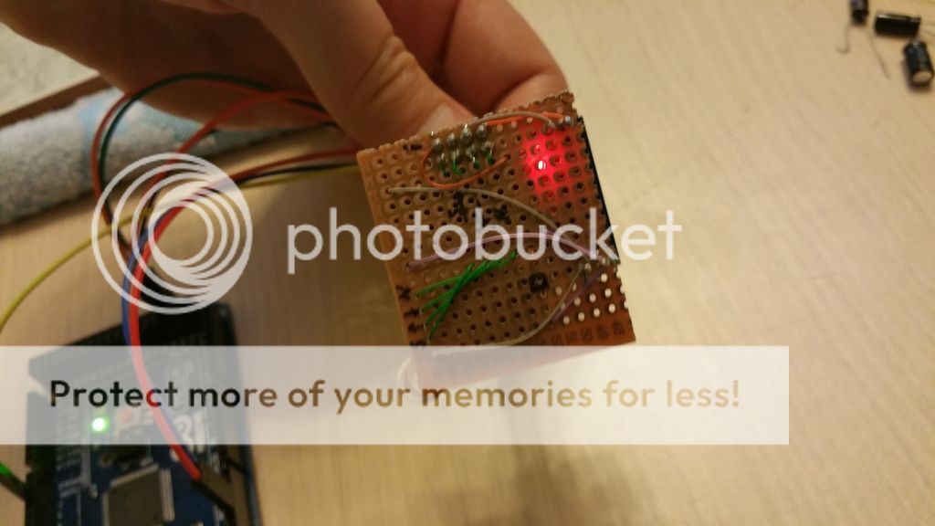

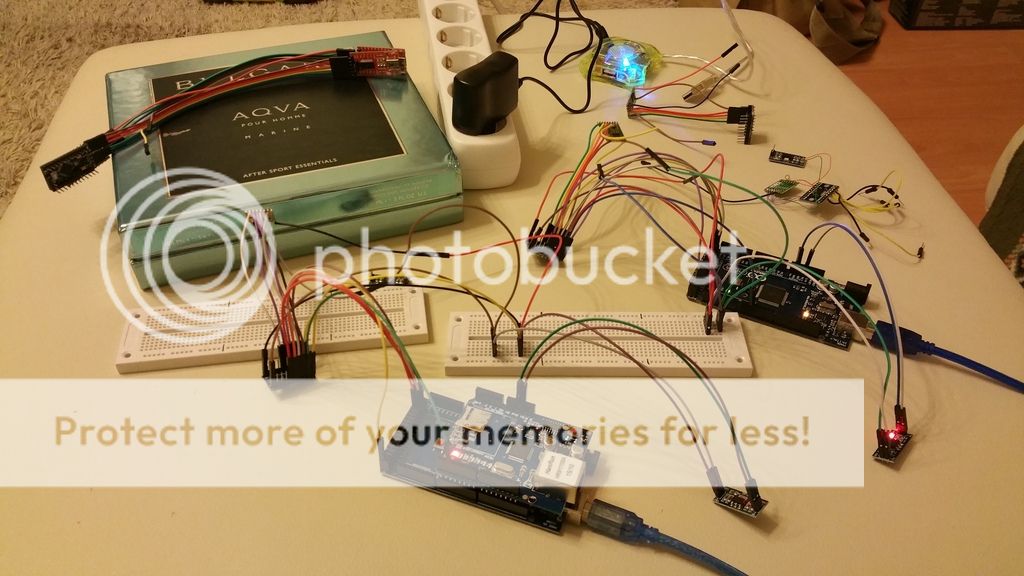

Hi again,
I've managed to build a few nodes using Mega2560, level converter, AM1117 LDO, using pretty long breadboard cables and lousy RF wiring, antenna measured by eye, all working good and stable. Excellent RSSI. (Maybe from the perfume chip box ;D )
Then I've crammed all up on some piece of perfboard, keeping all wires short, neaty, tidy.
And problems start to arise:
-only big packets going through, no ACK gets across
-replacing chip roles (send/receive) the same happens
-it only works when "cuddling" the chip, touching GND or the antenna
-the antennas were exactly 86mm long, as calculated for 868Mhz, tried trimming them to 85...84...83..., nothing
-added decoupling caps 10nF, 100nF, 10uF, 100uF, nothing
What i tried:

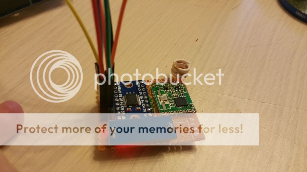

CUT the antenna in half and it started working but with really low rssi, like -70 at a few centimeters apart, but I get ACKs.
REPLACED antennas with 12cm antenna, works but still low rssi
CURLED 12cm antenna as in the picture, the signal is -93 at 5 meters through a door, direct sight, radio set at full power.
I've read somebody else having the same "chip needs cuddling" problem and it was due to some missmarked chips. So I did try the 433Mhz setting with the 86mm antennas but only got worse rssi and working seldomly when touching the antenna. Felix maybe you can shed some light on how to identify the correct freq of the RFM69HW.
And maybe somebody can explain how come the chip refuses to work when using the right antenna length but starts working when using a much shorter or longer antenna.
Thank you.

Hi Execu,
A reasonable guess for the poor performance would be that the ground wiring is long and thin.
You might experience much better performance with a ground-plane under the radio.
John AE5HQ

Probably EMI/RFI are also factors:   https://lowpowerlab.com/forum/index.php/topic,1538.0.html
Also, your RSSI numbers are quite high, no doubt from having them so close together.  That could mean more RFI through those long dupont wires from the close range.  Try putting them on opposite sides of the room and running them directly from 3v battery power.  That would narrow the list of suspects.  Any difference?
« Last Edit: February 06, 2016, 01:14:59 PM by WhiteHare »

What you describe sounds to me like poor RF grounding.
As for the ground-plane:
A piece of circuit board works great as a ground plane but, you could also use a small piece of sheet-metal (soup can).
It does not need to be perfectly sized. You could probably slip it under the radio with an insulator
such as cardboard or electrical tape to prevent shorting. I'd bend the edges up to make soldering to
the radio's ground connections easier.
I would be interested to see if it was helpful or not.
Good Luck, John
John AE5HQ

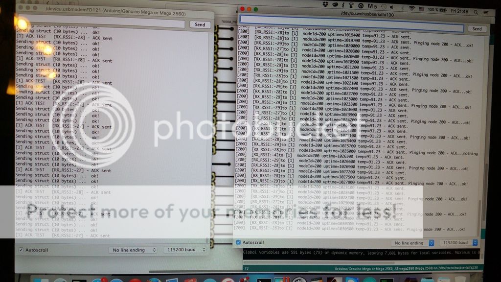

As for clues:
-sender says: sending...nothing
-receiver says: packet received. Pinging...nothing
Reversing send/receive sketch same thing happens. So the "main packages" get trough but acks do not.
Ruled out SPI problems since receiving works and printing registers spits the same values for different modules.
Shall try a groundplane or dipole later today. Computed the length to be 82mm for 868Mhz and that's what I'm aiming for. I'll keep you posted.
About the bootloader I've tried asking Joelucid for his bl as it doesn't require an external flash chip but had no luck. So I shall make my own starting either from stkv2 or the modified 2560 optiboot. That's the next thing on the todo list.
executivul
  • NewMember
  • Posts: 48
  • Country: ro
Re: Help identify RFM69HW variant. Weird antenna problem.
« Reply #8 on: February 07, 2016, 11:50:28 AM »
As I've promised an update:
Node 20 is the node without ground plane/shielding, uncurled antenna, 82mm vertical
Node 21 is the node WITH a piece of grounded tin can under the rfm chip, uncurled 82mm vertical antenna
The gateway is an RPi type B with a pro mini 5V + level converter + ldo + rfm 69 with an uncurled vertical 120 mm antenna, placed in another room, about 3m away, a concrete wall separates the rooms, there is a doorway between.
Conclusions:
1. there is no significant difference between node 20 and node 21, so the ground plane / shield is not any improvement. the rssi influenced more by the position of the node's antenna (more/less vertical).
2. touching the 82mm node antenna yields a rssi drop of 5-6db, so for the nodes the 82mm antenna seems to be in tune! Cuddling not allowed!  ;D
3. the rpi hat does not work with an 82mm antenna, can see packages received but can not send. The nodes get no ack. The server pings get no ack back. Touching the 82mm antenna (cuddling) makes the system work.
4. the rpi hat can send and receive with an 120mm antenna as seen in the picture.
Maybe I should join forces on the other thread about emi on the rpi.
« Last Edit: February 07, 2016, 11:52:50 AM by executivul »

Great job solving it.   Would please post a photo of the other side also so that we may fully admire what you did?
executivul
  • NewMember
  • Posts: 48
  • Country: ro
« Reply #11 on: February 07, 2016, 02:43:36 PM »
Of course, there it is.
Only one of the corners connects to the GND pin next to the ANA pin, the rest of wires are used just to keep things in place.
Sorry for the phone camera quality.
