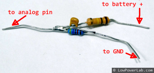

I think you are sending a metric that is read from a floating analog pin, that explains why the low voltage.
The WeatherShield has a "battery reading circuit" which is attached to A7 on the Moteino.
Your other "low voltage" node does not seem to have anything like that. Yet you are reading the input voltage the same way, it would of course read an invalid value that is probably very low.
So either:
- remove the battery reading code (also remove the V metric from the UI)
- add the voltage reading circuit (2 resistors, 1 cap) to A7, something like this:
loseymark
Amazing. With zero electronics training I was able to find the resistors and capacitor locally and put a circuit together on a breadboard that solved the problem. I had to use 2%
