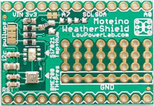

WeatherShield R2 released
UPDATE: A sample RFM69 sketch for WeatherShield R2 is posted here.
WeatherShield is now at R2 and although the PCB is very similar to R1 there are some significant differences. The R1 used to have a BMP180 until Bosch decided to stop making it. So R2 came about partly because of that reason, and is now shipped with a BME280 which includes all Temperature/Humidity/Pressure readings all in 1 sensor. This sensor is pretty popular it seems so hopefully the supply will be plenty for a long time.
Here’s a look at R2:
dsc_9859dsc_9860
And the schematic:schematic
Notice a few changes:
  • The voltage monitor circuit is now without a mosfet – this was removed and a resistor was added (the angled resistor) to tie the circuit permanently to A7. The old pads are still there so including the mosfet as on R1 is an option if someone really wants it.
  • there is now a solder jumper to allow disconnecting the battery monitor from A7
  • The Si7021 pads are still there if you’d like to add that sensor yourself
The board will idle at around 3.5uA when the sensor is put to sleep because of the voltage monitor. That’s still very low power but if you want 100nA instead and don’t care for battery monitoring, cut the jumper to A7. Bring your feedback in the forums!

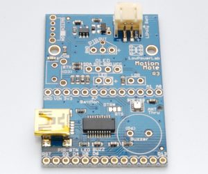

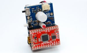

MotionMote R3 with BME280 & Panasonic PIRs
The MotionMote is now available with optional BME280 sensors and Panasonic PIR ultra low power sensors (the EKMB1201111: 5m 2uA, white). When you opt for the Panasonic PIR you get that instead of the chinese HC-SR501 with the appropriate enclosure front cover and required acrylic standoff. The guide explains how to use the standoff and switch the PIR input voltage from battery to regulated 3.3v from the Moteino:
DSC_9826DSC_9823
The MotionMote sample sketch was updated to include BME280 code support, but it’s commented out (will require a 3rd party library to read the sensor). If you get the BME280, make sure to uncomment the BME280 related code lines.

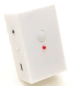

Although expensive, this PIR allows running on less than 10uA of idle current draw. Who thought that less power costs more huh! When assembled these will look like this:
DSC_9805
The OLED variant of the kit might be available soon as well, I will update the product page with that option when/if it does. That allows using this kit as a battery operated Moteino with a nifty OLED display for any general purpose use on your wireless IoT network. Here is that at a glance next to the regular HC-SR501 PIR based MotionMote.
