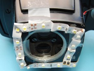

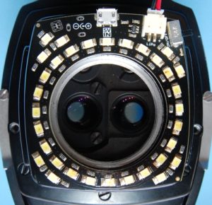

I have an Bausch & Lomb optical Stereo-Zoom (SZ4) microscope which is a great instrument and not a luxury when you do a lot of SMD prototyping and repairs. The light solution for this was a simple piece of white LED strip powered from a 12V adapter, worked well for over 6 years and I thought an upgrade to this will make a nice weekend project.
To really make this nice and portable it had to be very compact, wireless power from a rechargeable Lithium-Polymer battery. But how can this be powered from 3-4V when the LED strips require 12V?
Watch the details in the video below, along with a demo of laser-cut SMD stencils and complete hand assembly and test of the new light ring.
The before and after shots:
The design files are over at Github. Are you planning to make one or add more features? Did you learn something new from this video? Have a question or other suggestions? Let me know in the comments!
