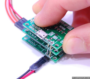

When I built the first revision of Moteino I had to come up with a way to program and test them quickly without having to solder the headers. I saw how others built complicated jigs for this purpose with all kinds of features, so I wasn’t very excited to do something like that.
It needed to be quick and simple (without the ‘dirty’) and also without a lot of waste – spring loaded test probes (aka pogo pins) are expensive and when revisions change sometimes the positions/function of the holes change as well and I didn’t want to spend a lot of time/$ making a jig. So I just stacked two of the same PCBs as the target and used pogo pins to hold the PCBs together (or rather the PCBs to hold the pins aligned and leveled). That worked great, with one hand I could hold/press the target PCB on top of the pogo pins, with the other do the programming.

- For the testing jig, I took two PCBs of the same type, and the pogo pins are inserted in the relevant positions, also making sure the boards are balanced for pressure (if all pogos are on one side they might break, so just add one or two on the other end to keep it balanced if you need to). I solder the bottom of the Pogo pins flush with the bottom PCB, and then solder solder the top PCB with the pogo pins’ notch inside the pin holes (that’s to strenghten and prevent them from breaking at that point – they will break eventually if you don’t do that). I finally solder male headers on the bottom for connections I care about and also any other peripherals that help me test/debug (like switches, LEDs, etc):
- Done!
The jig is ready for testing. For this board I actually added some more stuff to it later on (note the LED), but here’s how it works:
