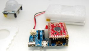

My mailbox notifier stopped transmitting the other day. It lasted almost 2 years since the last charge, with last reading at 3.56V. This was based on an old MotionMote R1 and Moteino R4, plus a chinese 2000mAh Lithium Polymer battery.  This device reports MOTION when mailbox is opened, along with a calculated LastOpened-ago metric and battery readings. Makes my life easy knowing exactly when there is mail or someone just opens it. And I can get IPCam snapshots if I need to when motion is reported. All very convenient.

Based on my previous LiPo freezing to death issues, I didn’t expect this to last thorugh a winter, especially being chinese, but it has gone through two Michigan winters and done the job well. The voltage was pretty linear decline as expected. I could optimize sleep current more and drop MCU sleep current to 35nA (not the PIR which needs to be active) with a TPL5110 timer, but the RFM69_ATC does a great job keeping TX power at a minimum while maintaining strong enough signal, this code upgrade alone has probably doubled battery life. Simply using watchdog sleeping is easy and decent enough for a ~2yr recharge cycle.

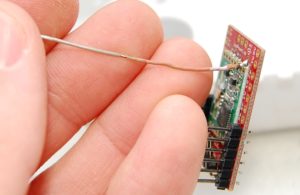

So it was time to service the unit, charge the battery, replace the antenna which being a simple insulated wire takes quite the abuse over time. And the unit being in an acrylic case without more than clear tape at the seams, there was a bunch of corrosion to clean up, and power switch to replace. I’m pretty happy these 2014 boards do well after so long, I don’t need to upgrade them to the newer MotionMote R2 and Moteino R6 boards, it just works.
Then I realized this used an old inefficient diode which dropped more voltage and wasted more reverse current, so I replaced that as well. The PIR is the chinese HC-SR501, uses around 55uA when idle, around 250uA active, I could do much better with the Panasonics 2uA PIRs which are available in the current MotionMote kit but I’m not sure it’s worth the investment for such a simple device that just reports when the mailbox is opened.
Having said all this, I believe the LiPo gets pretty worn by the extreme temperatures (both winter and summer) which LiPos don’t like at all. I am looking forward to see how this will do in the next 2 years. It may fail completely and I wouldn’t be surprised. If that happens, I may try a LiFePo4 solution next time.
