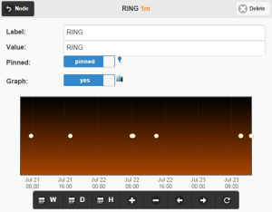

I’ve updated the DoorBellMote sketch to reflect the changes and make it respond to BELL:0 (disable) or BELL:1 (enable) commands. It now also sends a START message every time the Moteino is started/reset, this helps debugging any strange resets that should not happen and it illustrates how you could add your own custom messages or new metrics for debugging or other purposes. Here are the new set of commands defined in exports.metrics in metrics.js, the regular expressions of each metric have to match the incoming Moteino message:
exports.metrics = { ... //BellMote BELL_DISABLED : { name:'Status', regexp:/BELL\:0/i, value:'OFF'}, BELL_ENABLED : { name:'Status', regexp:/BELL\:1/i, value:'ON'}, START : { name:'START', regexp:/START/i, value:'Started'}, ring : { name:'RING', regexp:/RING/i, value:'RING', pin:1, graph:1, graphValue:1, graphOptions:{ lines: { show:false, fill:false }, points: { show: true, radius: 5, lineWidth:1 }, grid: { backgroundColor: {colors:['#000', '#a40']}}, yaxis: { ticks: 0 }}}, }
To add a new button to the Gateway interface, I need to define a new control in the DoorBell node entry in the exports.motes section of metrics.js:
exports.motes = { ... DoorBellMote: { label : 'DoorBell', icon : 'icon_doorbell.png', controls : { ring : { states: [{ label:'Ring it!', action:'RING', icon:'audio' }]}, status : { states: [{ label:'Disabled', action:'BELL:1', css:'background-color:#FF9B9B;', icon:'power', condition:''+function(node) { return node.metrics['Status']!=null && node.metrics['Status'].value == 'OFF'; }}, { label:'Enabled', action:'BELL:0', css:'background-color:#9BFFBE;color:#000000', icon:'power', condition:''+function(node) { return node.metrics['Status']==null || node.metrics['Status'].value == 'ON'; }}]}, }, } }

Here is the new DoorBell mote all wired up and the new UI in the Gateway. This shows the bell disabled. Pressing the doorbell button at the front door does nothing, now the baby can sleep uninterrupted. Pressing the “Ring it!” button in the UI will still ring the bell even when disabled (flipping both relays ON/OFF quickly from one state to another). And of course, even when disabled, if someone presses the doorbell button, I can still detect and graph it:
