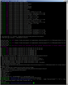

Next up is socket.io and node-serialport. Typically node packages will install in a subdirectory where you execute the npm install command, ie in the directory where your node app is located. In my case I am running from a home subdirectory dedicated to the Moteino gateway:
sudo mkdir ~/moteino sudo chown pi moteino cd ~/moteino
Now install node-serialport, which is needed to interface node.js to your Arduino/Moteino or whatever else you are relaying to your home automation hardware. This module gave me a bit of trouble also, but at the time of writing this it seems that it works fine with node 0.10.12:
npm install serialport
The install command should download the dependencies and source and build the module. Then you can check that it was built correctly by running this command that I found somewhere on StackOverflow during the hurdles I’ve had installing serialport, thanks to whoever came up with it, you should get “Looks OK” if everything went ok:
cd ~/moteino/node_modules/serialport if [ "x`find . -name "serial*node"`" = "x" ]; then echo "Something sucks"; else echo "Looks OK"; fi
Also, here’s a screenshot of the output during the install and the above check of serialport:
