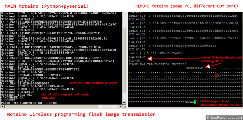

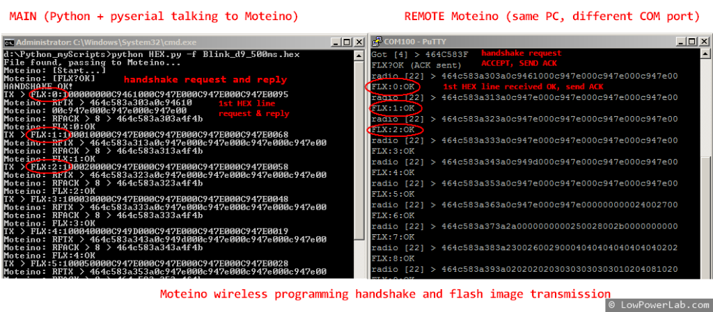

Here’s a snapshot of the transmission in progress. The first picture is the start of the HEX file transfer, second image is the transmission end, and reprogramming by my modified version of Optiboot.

The modified Optiboot now takes 1016 bytes, about 500 more than the original Optiboot. Not too bad considering it contains all the extra code to read from the external SPI flash chip and some basic serial output for debugging. I had to modify where the bootloader gets flashed on the ATMega328 (last 1k instead of last 512b). Here is an excellent article on AVR bootloaders: http://blog.schicks.net/wp-content/uploads/2009/09/bootloader_faq.pdf
One part I don’t like right now is that the serial communication between Python and the MAIN Moteino is rather slow (it takes ~15 seconds to transmit a blinky sketch). The reflashing by the bootloader is almost instant (second picture, the [FL***…***EFXA] part). It’s because of delay()s I added in Python and while using Serial.readline() to make sure I am reading whole messages and avoid any truncation. I will probably try to rewrite that logic to use getCh() instead of Serial.readline(). If anyone has suggestions please let me know.
Here’s a summary of all that happens:
  • Python script talks to MAIN Moteino. An optional -f blah.hex argument will hand over the HEX image to Moteino for transmission to remote Moteino.
  • Main Moteino intercepts handshake from Python host, attempts to contact the remote Moteino for wireless HEX image transmission.
  • Remote Moteino responds to the request and begins a wireless handshake transmission of the new HEX image to the external flash memory. When done it reboots via Watchdog.
  • Bootloader detects the new flash image and begins reprogramming the internal flash memory. When done it deletes the image to avoid an endless loop and reboots.
