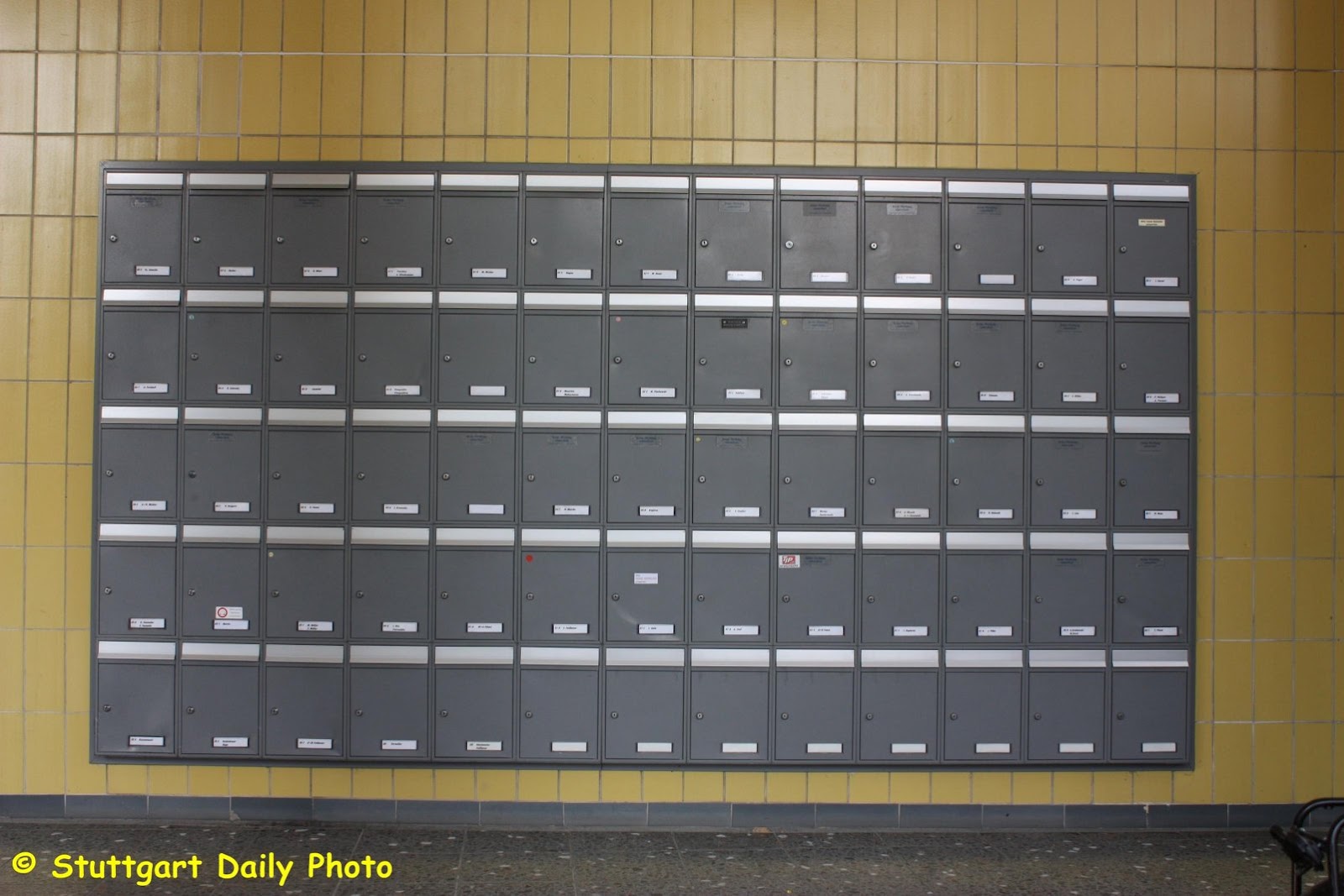

  14. I think this is a great little gadget. Now I live in an apartment building and the mail is delivered in a room and place in the mail box form the open back front looks like this http://2.bp.blogspot.com/-GFlroBQw4v4/Tbm4B5ujP6I/AAAAAAAABig/GbafRWQTmfw/s1600/stuttgart_20110501_002.JPG Now would there be a way for this to work on a motion sensor so when the beam is broken or movement is sensed when the letter carrier place a letter in the box it would start a count down of lets say 30 seconds (gives them time to place everything in there) and then send a text message? Lastly I think the real road blockl would be sending the signal from the mail box to your computer or reciver . As for myself I live in a high raise on the 18th floor so 18 stories of concrete above the mail box.
    • I dont think RFM12B is powerful enough for your scenario, unless you place routers in between to pass messages from one another to the main gateway. Also, RF wireless transmissions don’t like metal enclosures and concrete.
    • I have not planned to mass produce these. I started selling in an attempt to fund my side projects and this website, but it’s becoming overwhelming. Either way I think I’m still far away from huge scale production.
      Thanks for the MAKE link, it’s interesting, I’ve not seen that before. I am looking to get more projects done around the house, like a garage door status and HVAC control. Still in the alphas on those.
