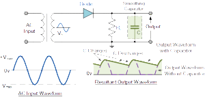

1. Getting 5V power from a 16VAC source
This is pretty trivial. We need to tap directly to the 2 terminals of the transformer, this is the 16V AC source that we feed from. All we need is a rectifier diode (1N4004 or 1N4007 will do) + smoothing capacitor (100uF is great, rated at least 25V or more) to go from a full sine wave to a half wave to a low ripple DC outout. My doorbell transformer is 16VAC rated and the peak-to-peak output is somewhere around 40Vpp. We then get a DC output that is around 18V which is too much for the Moteino so we can add a MC7805 5V regulator (which accepts up to 35V input) to get a stable and safe 5V source for the low power electronics. Here’s a schematic that shows how to go from AC to DC with a single rectifier diode and a smoothing capacitor, I tried all of this on a breadboard with a 12VAC transformer but it works the same as the 16VAC one:

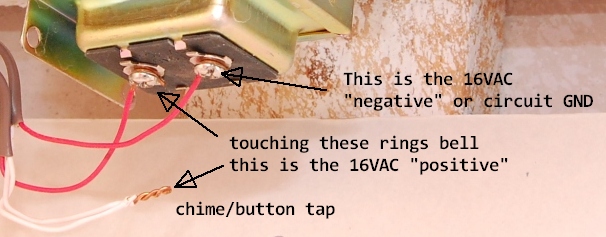

As I mentioned before, there are only 3 connections/taps into the existing circuit. The 2 red/black wires get the power from the 16VAC transformer. The yellow wire is the pushbutton tap which is used for the H11AA1 detector circuit and also on the relay output to simulate a door bell button press.

- The AC taps are not + and – like DC. They are just AC, pick one as reference and the other will sine around it. When we wire our circuit we pick one of the two to become our DC ground and we rectify the other with the diode/cap. To wire this all up correctly to the 3 taps you need to determine between which transformer tap and the chime tap there is 16VAC – that transformer tap will be your 16VAC, the other will be the GND. Otherwise you can short your own circuit when you close the relay, or have a constant ON input (red LED always ON), or perhaps other weird cases I can’t think of now. I guess it’s possible that a button/chime is hooked up backwards on the low side instead (opposite in my schematic above). You can also tell by touching the chime tap to the transformer taps. The one where it will ring the bell (aka chime) is your 16VAC input, the other is GND.
